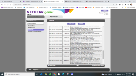

Re: Nighthawk CM1200-numerous critical and warning messages in log- connection intermittent
Dec 20, 2022Guru - Experienced User
Any Errors, Criticals or Warnings seen in the Event logs needs to be reviewed and resolved by the ISP.
Please post a copy and paste of the modems connection status and event log page.

Have the ISP check the signal and line quality UP to the modem. Be sure the ISP provisions the modem correctly.
