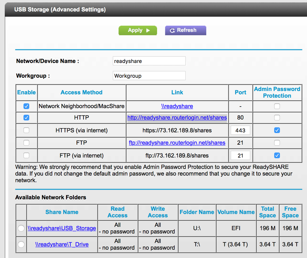

In the router admin page, I can see the drive and shares:

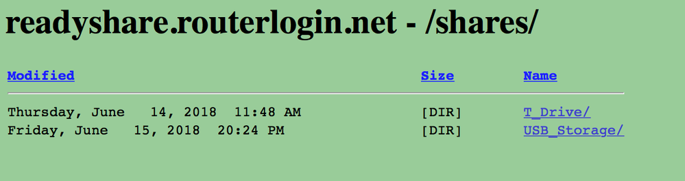

Using Chrome on the mac, I can see the HTTP: share:

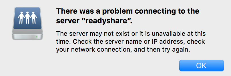

However, I cannot mount smb://readyshare, error is:

> Using Chrome on the mac, I can see the HTTP: share: [...]
That's at "readyshare.routerlogin.net".
However, I cannot mount smb://readyshare, error is: [...]
That's at "readyshare". Have you tried taking a hint from the thing
which works, and trying "smb://readyshare.routerlogin.net"?

I'd expect "smb://routerlogin.net" to work, too. Why the DNS server
on the router doesn't seem (always?) to intercept plain-old "readyshare"
is still a mystery (to me).
