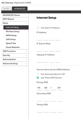

For IPv4, I was able to set it up no problem under the "Internet Setup" settings.

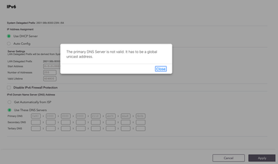

For IPv6, I need to use my DNS server's link local address in order for it to operate privately. If I try that, I get the error below (requiring that I use a global address).

    You are getting the wrong ipv6 info.
    Reason I say that is in your post, I can see above that your LAN delegated prefex preference is to start at the 2601:..........
    so if you have a device on the network with an ipv6 address, it'd start with that.
    Problem is on private networks, the FE80 is basically saying its locally administered link-local address. (pita)
    It needs to be the global address that starts with the 2601.
    Try setting up the ipv4 and ipv6 address to use your isp's.
    Then after the router reboots, disable/reconnect your network connection.
    then go to the ipconfig through the command prompt. When you do that, it should give you your ipv6 address and not just the local link one.
    Thats what I had to do with my pihole to get the ipv6 address.

      I do have a global unicast address I can use, but I prefer not to use it. My ISP could cause the DNS server's GUA to change, which makes it a less preferable choice as a permanent router setting.
      It may not be possible for this brand/model to allow a non-GUA as the preferred IPv6 address, which is fine. I just wanted to know so I could try and find other routes to solve the problem.
