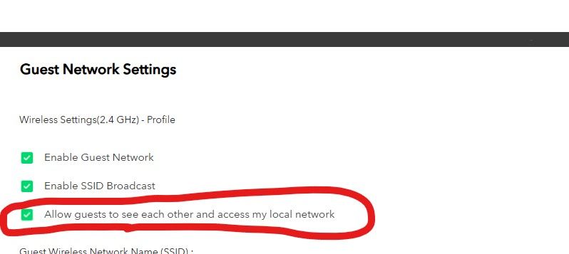

  • Had the same problem with RS200 router with a 3D printer, once I turn this on below, it allow my 3D printer to talk to it's own URL of 192.168.1.218 that was assigned by the 3D printer.
