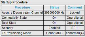

Hello there. I'm having some issues with my internet speed here at home and want to make sure i'm chasing the right problem. I've called my ISP, Suddenlink, about slow speeds and keep getting told ...

Your power levels are out of spec, your have a ton of errors, and your channels aren't all locking.
Check your line for kinks, damage, bad/old/cheap/corroded connections and replace them if you have them.
Remove any splitters or signal attuators from your line.
Preferably move the modem to right where the line comes into the home to avoid lines inside the home being the issue.
If none of this helps, then the ISP needs to check the line.

All lines used were installed by my ISP when we got their service. ISP was out today (finally, its been a few months with this) and checked all the lines and discovered that the tap outside the house was bad. should be replaced by Tuesday.
