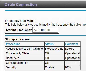

do you have a screen snip of the modem's cable connections page? It shows upstream/downstream connection info.
As well as the event logs.
That lets us check the signal from comcast.

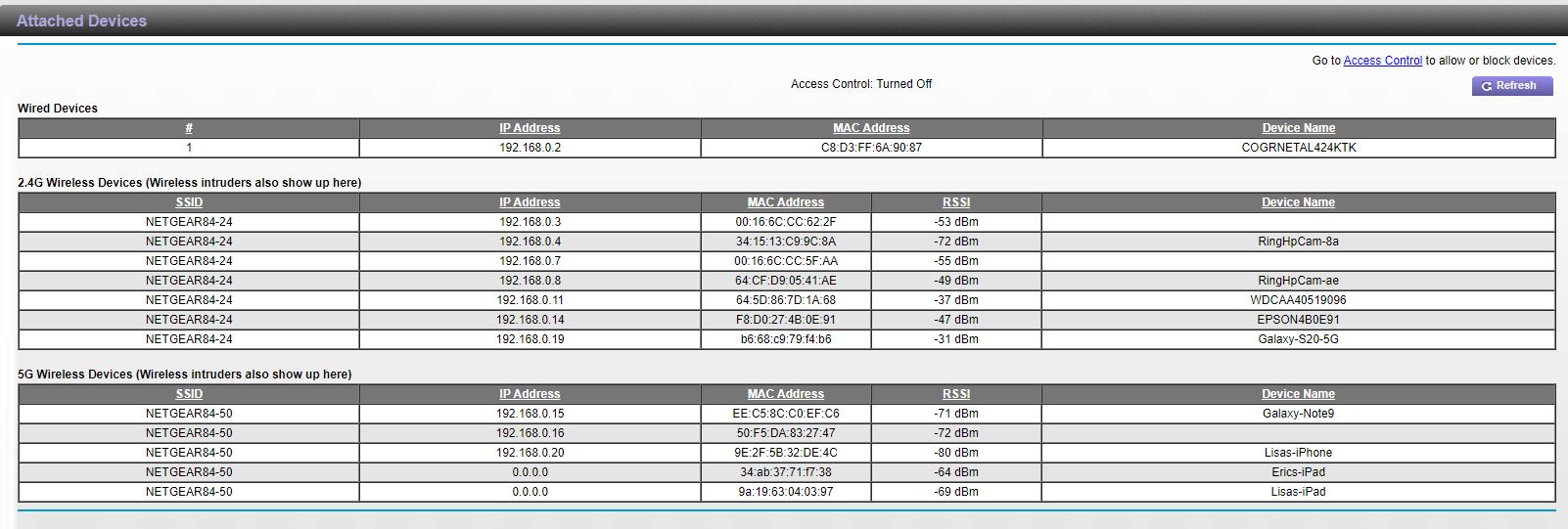

Greetings,
As pre your request, I have attached the various pieces of information. Even fresh out of the box (factory settings) the speed was an issue. Hopefully this information will help to identify the speed problem.
Access control is off (never turned on). Same for traffic metering, Parental Controls. Not sure where the QOS setting is?
