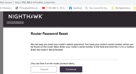

Unable to log into CAX80 it reverts back to PwdRec
When I try to access the CAX80 at 192.168.1.1 it reverts back to 192.168.1.1/PwdRec_index.htm. The only way I can get rid of this is to reboot, but that becomes annoying over time. Any help would b...

- tobiasrubinDec 05, 2022AspirantI have the latest FW.
Doesn't matter what browser is used.
Yes I tried clearing history, cache, etc.
Nothing seems to work but a reboot, and then in a week or so it happens again.- FURRYe38Dec 05, 2022Guru - Experienced User

- tobiasrubinDec 05, 2022AspirantYes I have performed a complete factory reset and eventually the problem comes.
