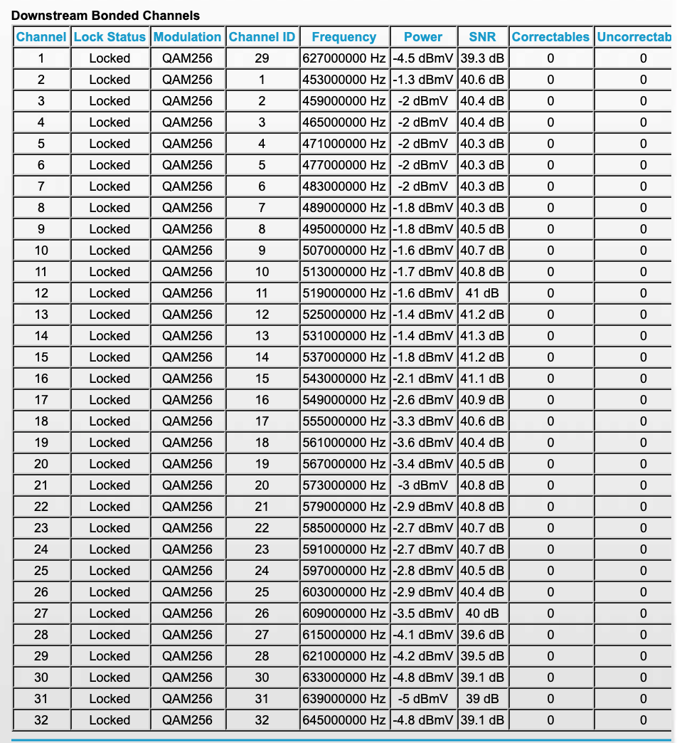

You've got errors on channels 30-32.
Problem with adding an amplifier. Yes it gets your signal to the good range. but if you're amplifying a bad signal it doesn't help. and can create issues on the upstream.
Try this. directly connect the modem to right where the coax enters the home. without the amplifier or any splitters. use the setup for a little while (to get some data moving), then take the same screen snips. lets see what it looks like then.
If that all looks good and the signal doesn't have errors and can tolerate a splitter then we move on from there.
the prefered way to run with cable tv and modem is a dual splitter when it enters the home. One leg goes directly to the modem and the other to amplifier/additional splitters needed. TV's and voip tend to tolerate erros/signal amplification better.
this gives the best signal to the modem with the least amount of issues.

plemans Thank you! I will definitley try that. Currently the splitter I have is a 4 way due to the amount of outlets in the house. If I run a 2 way splitter off the main line, I will have to run one more splitter off the amp.
So new setup would be:
Main line into 2 way splitter --> 1 line direct to modem, 1 line to 'in' amp
Amp 8 channels --> 1 line to additional 2 way splitter

Hi, uploading my latest signal levels with new configuration.
New config has the main line to a two way splitter..one to modem, one to tv. Signal levels are down from where they were when connected the amplifier, but no uncorrectable errors as of yet (Modem has a little over an hour of uptime & signals are still in spec).
