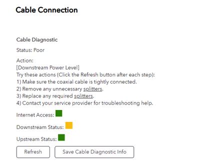

Here you go:
The interesting thing to note was that, prior to the tech coming out, I've never had any random unknown wired connections. That said, my cable connection always was listed as "Good". So, the speed issues i've been encountering existed regardless of what the cable connection status was.
