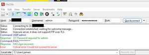

Hi, I recently left home and I used to upload locally to a USB drive plugged into the back of my CAX30 router to share with my brothers computer. Now that I am in a different city I am tryi...
opop
May 10, 2023Aspirant
Hi,
I dont know what it was but I reset the password and I was able to get in, maybe it doesn't like $ signs

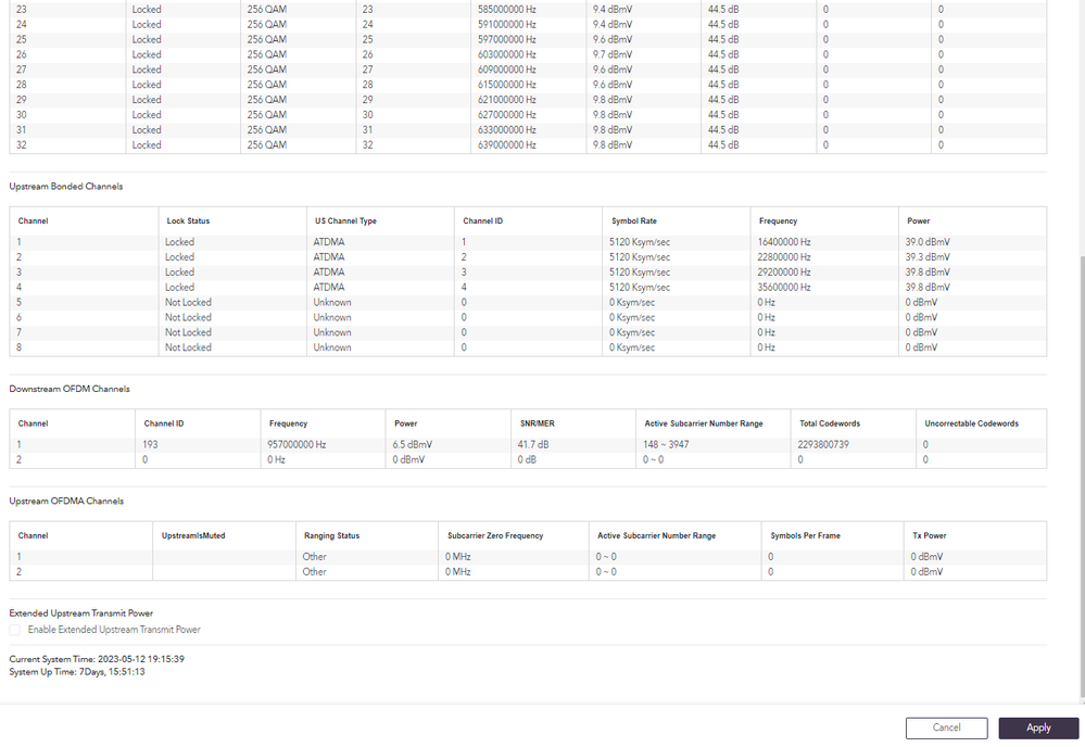

ultimately though the router is still not doing what I need it to do, when uploading large files the connection times out, I can only get about 5mb/second and upload 1 gigabyte. I tried multiple clients.
- FURRYe38May 12, 2023Guru - Experienced User
Please post a copy and paste of the modems connection status and event log page.
https://kb.netgear.com/30007/How-do-I-obtain-the-cable-connection-information-from-a-NETGEAR-cable-modem-modem-router
https://kb.netgear.com/30008/How-do-I-view-or-clear-the-event-logs-on-my-NETGEAR-cable-modem-or-modem-router- opopMay 12, 2023Aspirant
Hi,
I am on firmware V2.1.3.10
cable connectioncable connection 2event log
