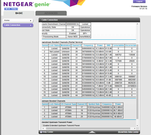

Very bad comcast signal, latency and disconnects. Is it a Comcast problem or a modem/router problem?
Normally I get about 500-600Mbps, but it's been about 5-10Mbps lately. I did a firmware update on my router (Linksys WRT 3200ACM, fresh latest OpenWRT) thinking it might fix/help but it didn't. I had...
Nov 11, 2024Guru - Experienced User
Power levels are a bit low and maybe some channels are too low:
https://kb.netgear.com/24311/Power-level-guidelines-for-a-NETGEAR-cable-modem-router
Seeing lots of correctables and un-correctables that should be mostly zeros like the other channels.
Please post a copy and paste of the modems event log page.
