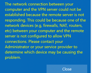

I have been unable to connect to my company's VPN for approximately three weeks while using the same router and devices for months. I performed a factory reset to my Netgear AC1600 router/modem with ...

Thanks for the reply. I am able to access the vpn on other networks including my verizon hotspot. All settings are accurate to connect to the VPN on the devices. I have partnered with our IT department and they are saying the issue is specific to my router and the double nat issue.

Also, I went into WAN Settings and set the DMZ to the ip address my Dell Latitude was on and still unable to connect to the VPN with same error message.

I appreciate your response. Any thoughts why my devices connect to my work VPN without any issue on half a dozen other connections? I have tested on my Verizon Hotspot, T-Mobile Hotspot, and 3 additional routers (neighbors, friends, parents) without issue. I am only unable to connect via my router and it is the only one that when i run a traceroute on has two individual ip addresses in the first two hops. I am convinced the issue is specific to the 192. & 10. double nat.
