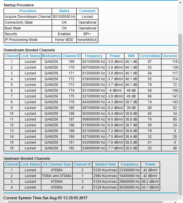

I am troubleshooting a problem with my CM500 cable modem where the Internet sporadically drops or partially drops. What does a flashing green upstream light mean? I have looked in Netgear's offi...

Can you be more specific? What does partial upstream service mean?
Here's a sample of what I was seeing during one of those outages:
- vkdeltaAug 05, 2017NETGEAR Employee Retired
are you sure you captured this exactly when US lights were flashing or after sometime?
the screenshots show Upstream channels are ok.
- jasonrdavisAug 05, 2017Aspirant
My apologies, I posted the wrong screenshot. It is flashing green right now (all others are solid green), and the Internet light is also flashing green. This is what I see:
we cannot see screeshot. Please post again and capture exactly when the problem is seen.
