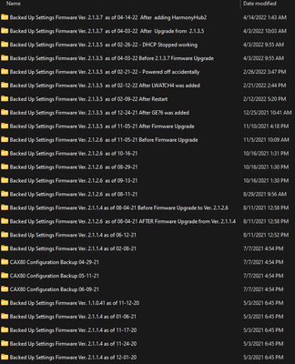

I highly recommend that you take a backup configuration snap shot and save to file after the modem is fully setup. This will help save some time if the modem resets to factory defaults on it's own.
- tamanacoJun 10, 2022Apprentice
I have a zillion backups.. when I restore them, the Address Reservation table and the device names are lost. I also need to re-authenticate after I restore to the previous backup that was saved with the full configuration.
