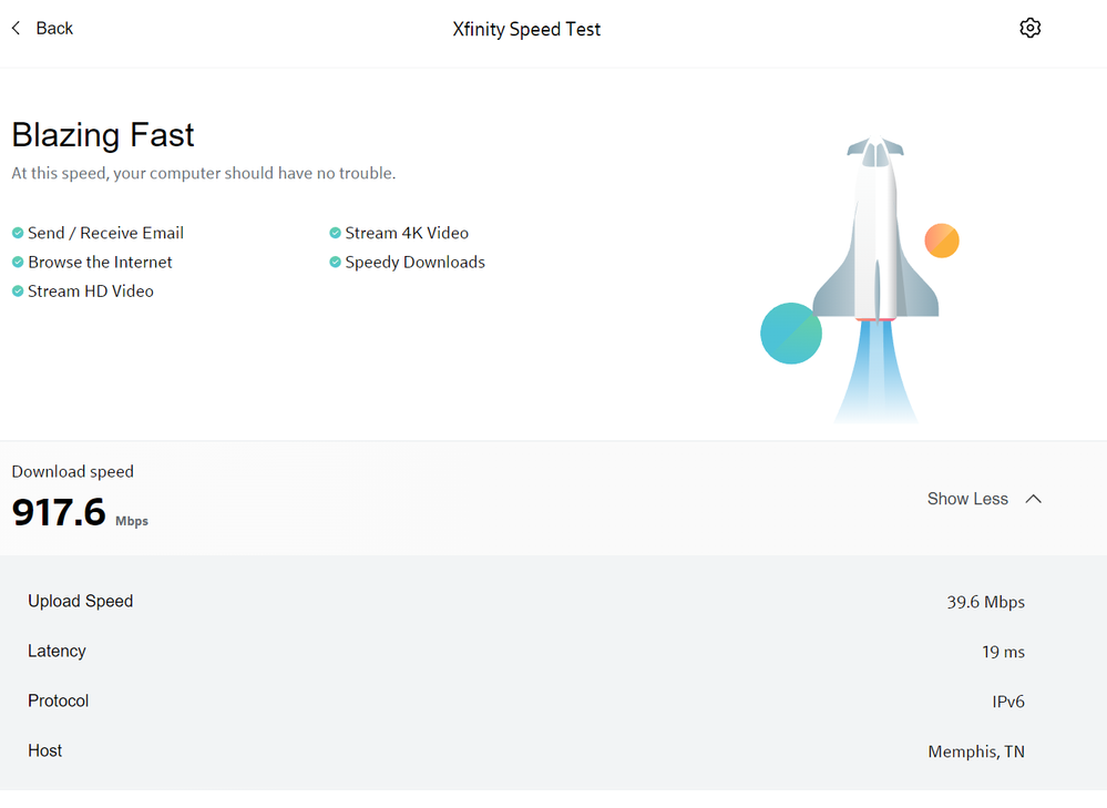

- strykerzr350Feb 15, 2022Guide
Netgear has the modem rated at 800 mbps down on their site. Xfinity has it rated at 927 mbps down since it is the CM1000v1 version and I get that its not supported on there anymore, for whatever reason. From what I understood it was because the older chip was expensive, and it had router like features, the new CM1000v2 has those features omitted. With the Xfinity speed test this is what it showed directly connected to the PC. It seems the attachments take a few minutes to show up. Still no over provisoning on the download but the upload it did have it.
