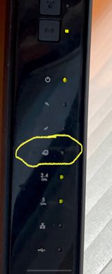

Why can I NOT find Advanced settings Netgear C6230?
Been everywhere and cannot find out why I cannot see Advanced Tab when On my Netgear page online with Netgear Page or Nighthawk. Im trying to find out why Online Internet Led light will not come on....

I have tried Chrome, Safari, IE.
No splitters
Xfinity checked and found no issues. I have my own Netgear so they sent me to Netgear.
Did all the steps you mentioned.
When I go to routerlogin.net i do see my product, but nothing that leads me to the cable connection Info. Then i get a message to confirm my email address. BUT I Do not get the confirmation email to confirm. Yikes.

I know ----- but I keep getting this message,. If I ignore it, i can get to this screen which does not show links to the cable info details.
