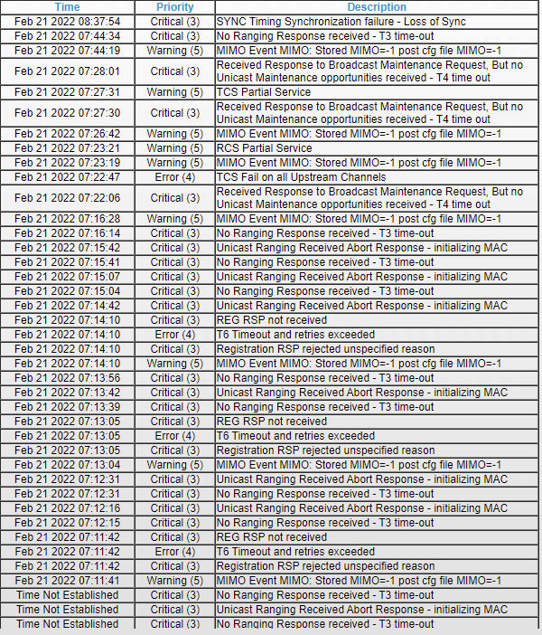

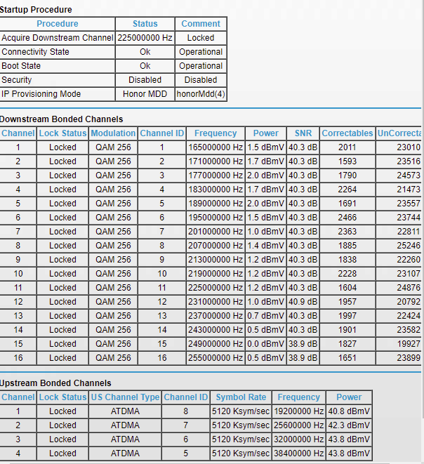

do you have a screen snip of the cable connections page and the event logs?
- 60139pilotFeb 21, 2022Aspirant
