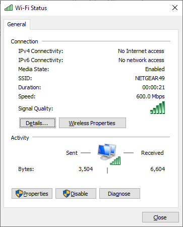

      • FURRYe38's avatar
        Those are link rates only. Not actual thruput speeds which differ from link rates. The link rates are the actual speed rates seen between the modem and a wireless device. See my included picture of my DWA-192 connected to my C7800. Thats just a link rate.
        https://kb.netgear.com/19668/Link-Rate-and-Transfer-Speed

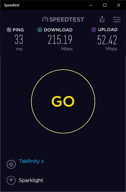

        Speed testing bandwith will be always lower than the link rate.
        Here is a sample speed test with a D-Link DWA-192 USB 3.0 wireless adapter, 3 feet between adapter and RAX, connected at 600Mpbs to a NG RAX80 router in AP mode with 2.4Ghz radio only, 40Mhz only on a 1Gb/50Mbps ISP service line:
        So it is possible to get 60Mbps over 2.4Ghz, depends on configuration and hardware support. Lower Link rates will see lower thruput speed rates.
