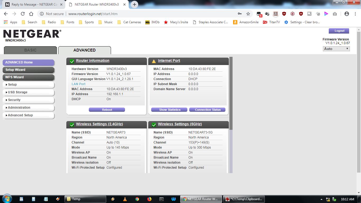

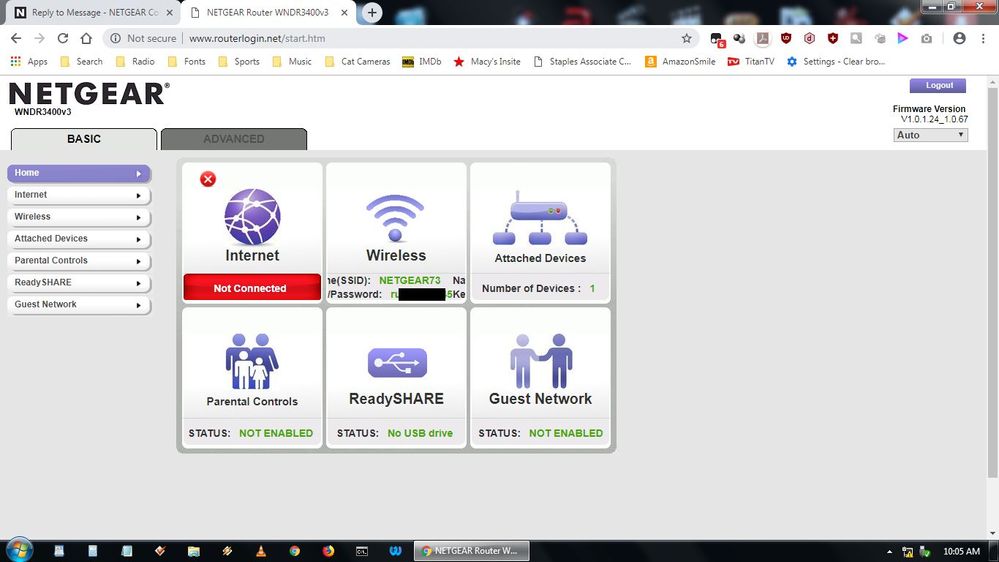

I have always had three devices connected to it: the PC on port one, an Android TV box on port two, and a Samsung smart TV on port three. I have not changed anything in this configuration since I installed it. The router worked for months until suddenly it stopped working. While I seldom used the wi-fi, I can confirm it ceased working at the same time.
Per the manual on page 12, the presence of the internet LED in solid amber would indicate "The IP address was not acquired." I can perhaps screenshot the Genie program if it might help.

- ChadwyckeApr 28, 2019Aspirant
My understanding from Charter Spectrum's tech service is that the Arris is configured so that only Port 1 actually works on it. I have verified that hooking devices to any of the other ports on the Arris does not receive signal.
A networking cable goes from that port 1 to the WNDR and then the three devices are hooked up to it.
This configuration worked for months until it suddenly ceased. I've reset the Arris using the reset button, as well as leaving it unplugged for hours. It has no battery back up.
I've disconnected all the devices from the WNDR and reset it. I've reset it with all the devices connected. I've replaced the yellow cable with a brand new length of cable.
I still only get signal when the device is hooked directly to Port 1 of the Arris.
