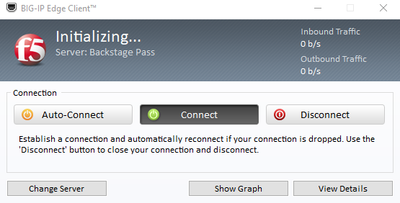

Prior to getting this new modem router, I was using the Xfinity model and it worked perfectly with my work VPN (BIG-IP Edge Client - F5). Once I switched to this new modem, I've been having issues trying to connect my PC. Mind you, my PC is connected to the Modem via Ethernet. Now here is the confusing part, if I open up my work laptop, and use the wifi, I can connect to the VPN with no problem. Looks like the issue is when I'm connected via ethernet.
Has anyone experienced this before? What is the workaround for this situation OR possible solution?
Here is what I'm seeing when trying to connect.

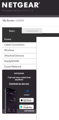

Firmware for reference:

        What version of firmware do you have installed on the router side of your CAX30?  A version number please, a response of "the latest" does not allow for confirmation and may be in error depending on how you made that determination.
