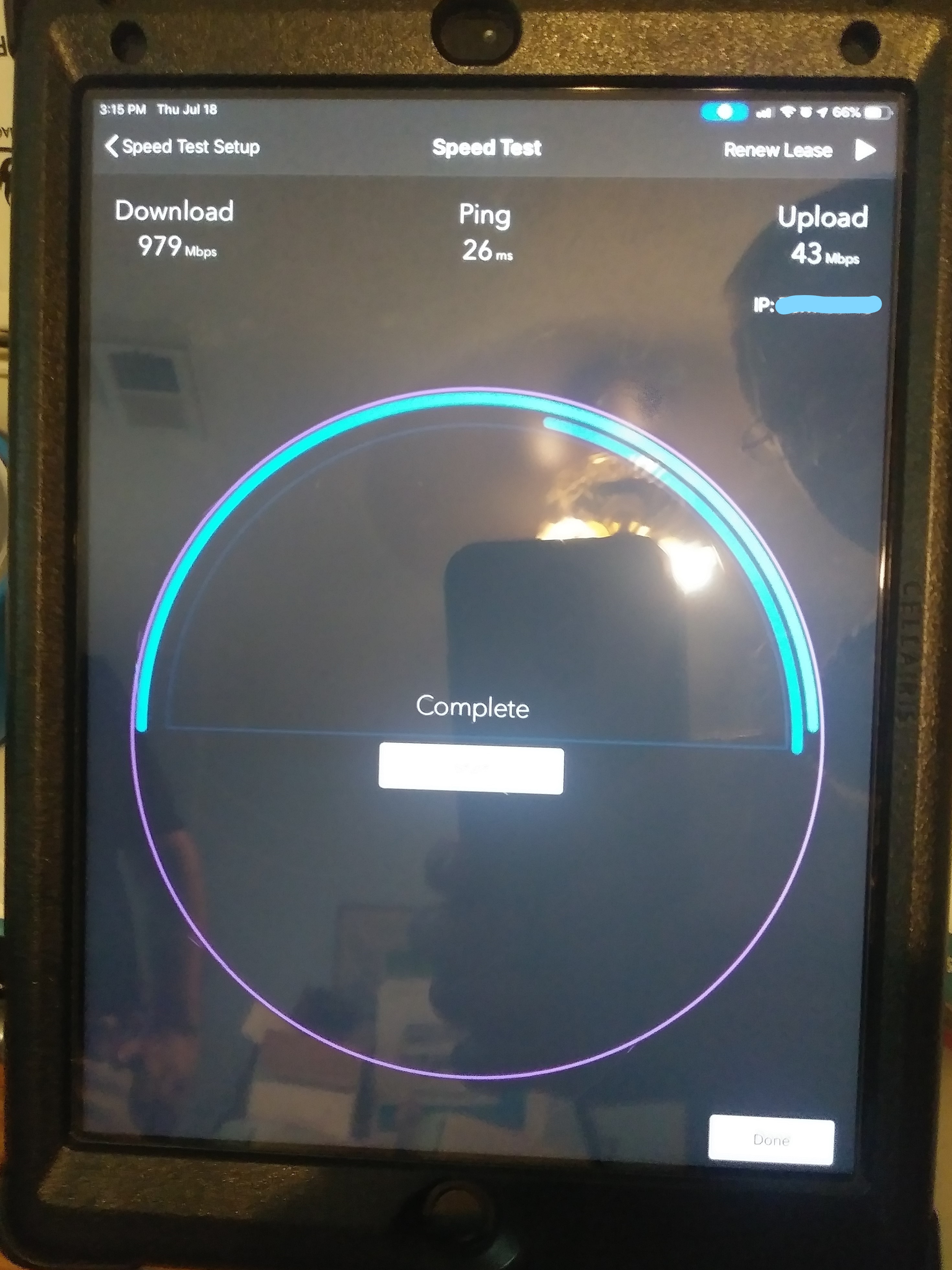

      First pic I uploaded was off the CM1000 directly....
      This one is off LAN port coming out of my Asus RT-AC3100.  With Trend Micro's settings all on & QoS set to "(Adaptive)/fq_codel/& Cable DocSIS/with Media Streaming chosen...
      Missed snapping screen on 1st run off the CM1000 when it hit 1.1gbps+!!!!
      They finally sent out a tech (gigabit on w/o) that knew what he was doing & found simple things the others not only did not attempt to figure out but said blah blah blah your within limits to not be our worry... sad.
