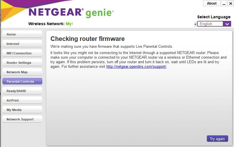

I downloaded Genie and it's indicating that it cannot login to the router and that the PC are not supported on this device or firmware?    Is that accurate or is it just that NetGear moved on from OpenDNS and it's simply not an option any longer?
    If by "genie" you mean the mobile app, rather than the desktop program, the genie no longer supports the R7000. A firmware update moved it over to the Nighthawk app.
    Which products support the NETGEAR Nighthawk app? | Answer | NETGEAR Support
    Which NETGEAR home router models can I manage using the NETGEAR genie app? | Answer | NETGEAR Suppor...
    The latest Nighthawk app no longer supports standard Parental Controls, only the paid for Circle.
    This still works but you'll have to use the desktop genie program to manage the controls.

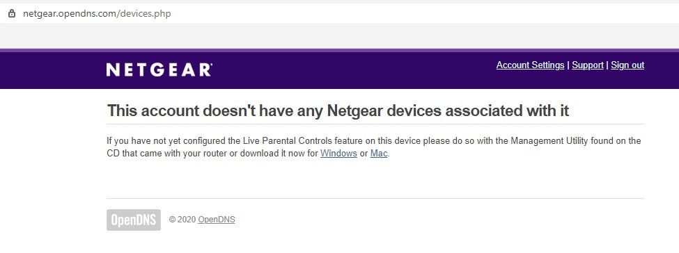

      I seem to be stuck in the NetGear Bermuda Triangle:
      - netgear.opendns.com reports that I do not have a registered device available, use <desktop software> ( <-- Genie, correct?)
      - Current version Genie reports router is not supported

      • michaelkenward's avatar
        michaelkenward
        - Mobile app does not support netgear.opendns.com
        You need to set up parental controls on the router before you can start using it.
        Do this with the browser graphical user interface (GUI), not the genie.
        Read the manual.
        Visit the support pages:
        Support | NETGEAR
        and feed in your model number and check the documentation for your hardware.
        The fact that your router is second hand may mean that it was already registered for parental controls.
