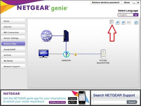

        You can do the same thing if you can lay your hands on another useful utility that Netgear has tried to kill off.
        genie | Product | Support | NETGEAR
        It has a useful Network Map, with a separate "button" to show Powerline devices.
        Right click on the plug and you'll see a set of options.
        If Netgear can't find the plugs, that may be another clue.
