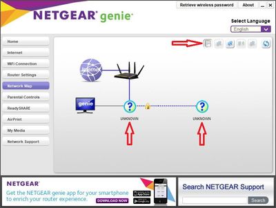

      If I want to do anything with the plugs, which is not much. (They are just plugged in and doing their stuff.) I use the desktop genie program.
      Powerline Network Map
      For fancy moves, I might dig out one of the programs from alternative brands, ZyXel or devolo. But, like I said, what is there to do?
