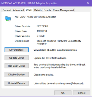

I am on the most current build of Windows 10 to include have the latest driver to the A6210, which is ver 1.0.0.39. You should see Win 10 32/64 bits driver version: 5.1.35.0 in the Driver tab or as in Example 1.
Example 1: Driver Version

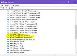

In the Device Manager, at the top, select View and then Show Hidden Devices.
Notice that in Example 2 that I have two ghost devices with their drivers still remaining on the machine. Only look for the network adapters like the ones that I highlighted. Do not remove anything else as it's needed by Windows 10.
Reboot the machine after removing these to ensure Windows 10 will finish cleaning up the leftover drivers.
I performed these steps and did not have another disconnecting issue, but I would suspect that there is a conflict with Bluetooth being enabled.
