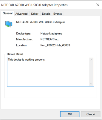

- michaelkenwardFeb 24, 2023Guru - Experienced User
doctordon wrote:
There isn't a power tab for the A7000's properties
Where are you looking?
Wifi adapter properties
- doctordonFeb 24, 2023Tutor
Device Manager > Network Adapters
