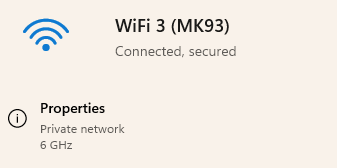

Secondly, I am wireless with a TP Link 6/6e router which supports this band and also using Windows 11 Pro. The best speed that I'm getting is 866/460 when I switch to the 6G side of the router. It was either in the folder on my C: drv of MTKOEMX or MT7612U that stated that 866 mbps was the max speed of this adapter. I confirmed this by switching to 6G side and it displayed 866 mbps. my 5G side is 1201/1201 and the 6eG side should at least be getting the same speed as I understand. Placing it on ax side rendered everything blanked out, placing it back to ac, everything works as usual.
What may be done to get true 6e operational with the max speed assured with the A8000??

      I would like to thank you for confirming my question and responding so quickly. I had a thought that I may be correct, however, I wanted to hear from others regarding this new update. I initially tried to install it but it said it was for an A7000 or something, and I deleted it. Never desire to whack up a device by downloading incorrect firmware.... Learned that lesson the hard way.
      I have installed this new update and I can't seem to discover anything new. I am unable to get the 6e side up and running, when I logon to the 6G side of my router, my speed is only 866. I have the TP Link Archer AX6000 Router which handles Wi-Fi 6 and I haven't quite cracked it to allow at least 1201 speed or better. I shall continue until I do make this function properly.
        WiFi 6 is not 6 GHz if that is what you mean by 6G. That is 6E. (Why do they set out to confuse us like this?)
        The links I followed to check on the AX6000 suggest that it isn't a 6E device.
        I find that the only way to work out which band I connect to is by looking at Windows and what it claims the connection is. I don't have portable stuff that does 6GHz.
