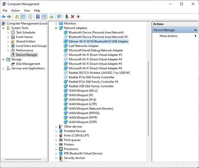

My next suggestion would have been to tell Windows to forget the "hidden" USB versions of the drivers.
Every time you connect a USB device it adds it to the catalogue of known devices. It can help to delete the ones that are no longer connected.
Wifi adapters
Look in "Device Manager" for "Hidden Devices", and remove, the ones that are no longer connected.
Your problem sounds more troublesome. You may be into "system restore" territory. But this may not be the best place to go into that.
