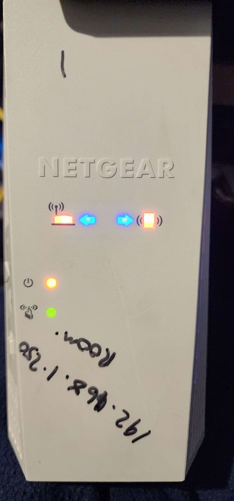

All lights on, can't reset EX6250
You know how they say if you turn it off and back on again, chances are it will work? Well in this case it seems to have had the opposite effect.
I switched off the extender during a routine network reset, and when I turned it back on again, all the lights came on and it won't do anything. Plugging it in via ethernet shows a green link light.
I've tried resetting it, I've tried manually uploading firmware to it with tftp, and all came to nothing. Extender was bought in 2021 so probably out of warranty by now.
Is there anything I can do to reset it or am I just boned?
    There you go: Usually if its blinking green, something went wrong during the update and its stuck.  You can force install the firmware to the device. Any time you do an update I recommend doing it over a hardwired connection. I know the option is there to auto update but most of the problems happen from that features.  To force the firmware to it, you have to use a tftp procedure.
    https://kb.netgear.com/000059634/How-to-upload-firmware-to-a-NETGEAR-router-using-Windows-TFTP
    also make sure to enable tftp from within windows 10 (if thats what you're using)
    https://www.thewindowsclub.com/enable-tftp-windows-10

      Thanks for the reply!
      So far as I know, there was no update going on with the extender when I turned it off. I only tried to update it when it stopped working.
      I tried all of the steps that were linked, and it didn't work. I constantly got Connection Timed Out.
      I tried tftp and nmrpflash and neither worked.
