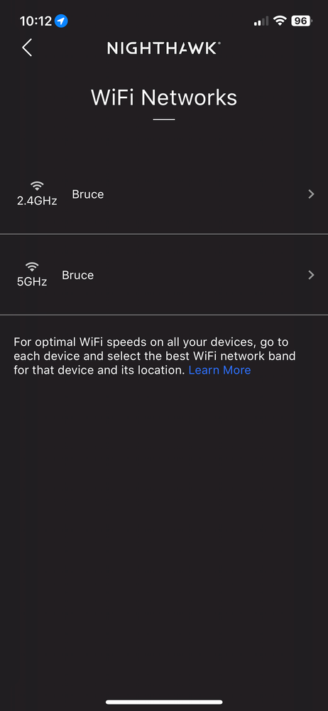

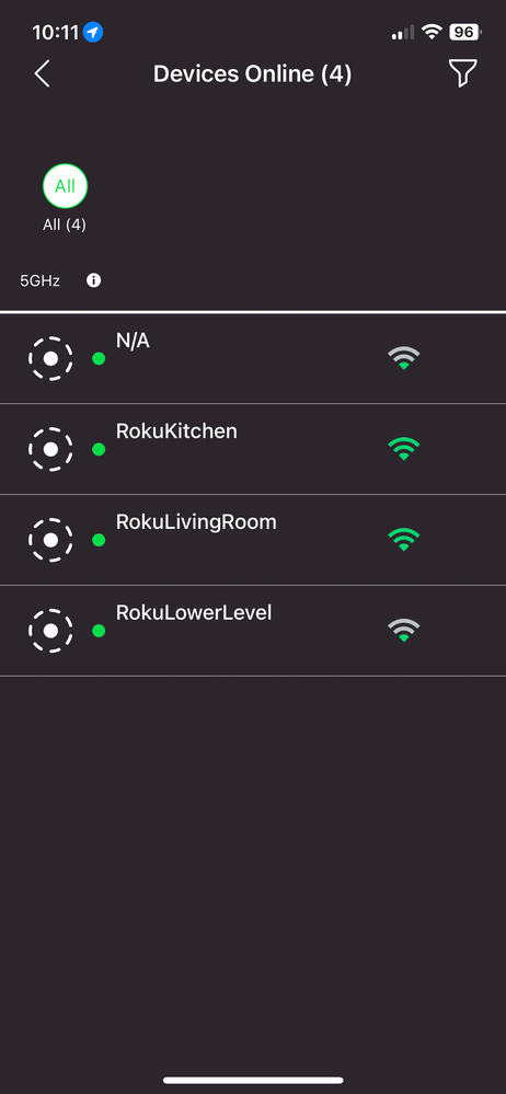

I have a T-Mobile Home Internet gateway that sends out both 2.4GHz and 5GHz bands on one SSID. I setup my new EAX12 Extender yesterday with the help of a Netgear support technician. We could not get the EAX12 Extender to see the 5GHz band transmitted by the gateway. It did see the 2.4GHz band, so we just continued the setup using the 2.4GHz band. After the setup was complete the Nighthawk app shows my 5GHz network. I'm convinced that my both my 2.4GHz band and 5GHz band are both being transmitted by the EAX12 Extender. Has anyone else had this experience?

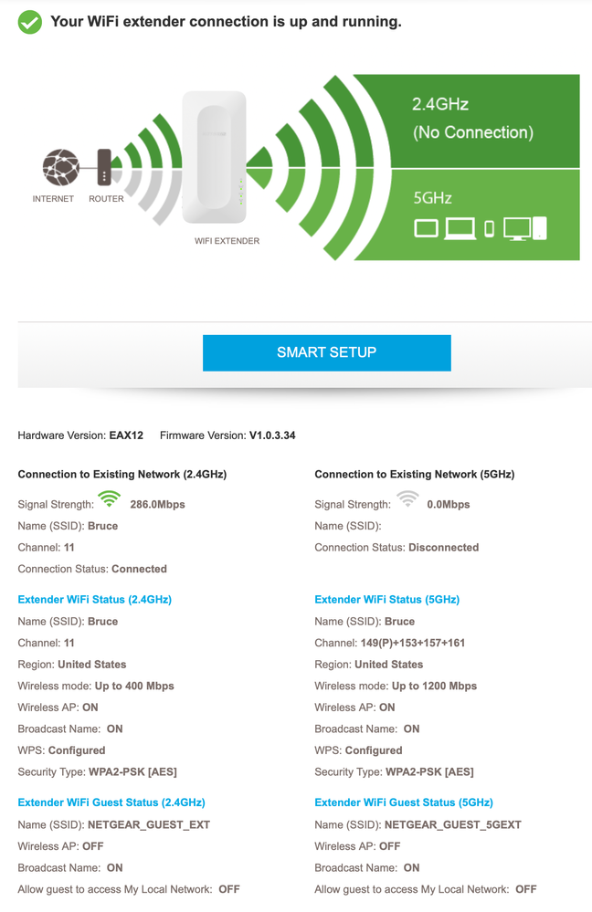

    You can log into the extender through the browser and setting its status page from front haul/backhaul.
    Log in that route and get a snip of that screen and it'll tell you

      I don't know what you mean by "setting its status page from front haul/backhaul." Here's a screen shot of the browser page. It shows no connection to the router's 5GHz, but it shows all of my connected devices using the 5GHz. It's confusing to say the least.

        Correct, you don't have the 5ghz backhaul setup to the router. And 2.4ghz is a really slow network. So everything is running through that and probably not working at very fast speeds.
        I'd rerun the installation assistant and try to get the 5ghz connected.
        what router are you connecting it to?
