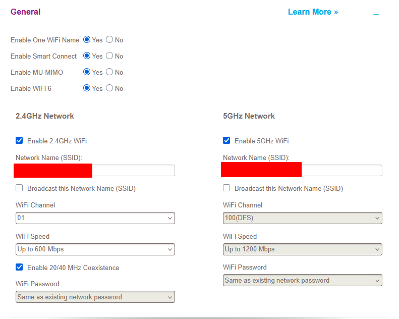

As i don't have LAN connections in the house and my powerline device (Netgear PLP2000) are very unstable, i bought a `AX1800 WiFi Extender (EAX15v3) wifi extender with ethernet connection.
I configured the extender as following
When i connect a laptop with static IP address, it works fine and the laptop shows in the Wired devices on the EAX15v3 device.

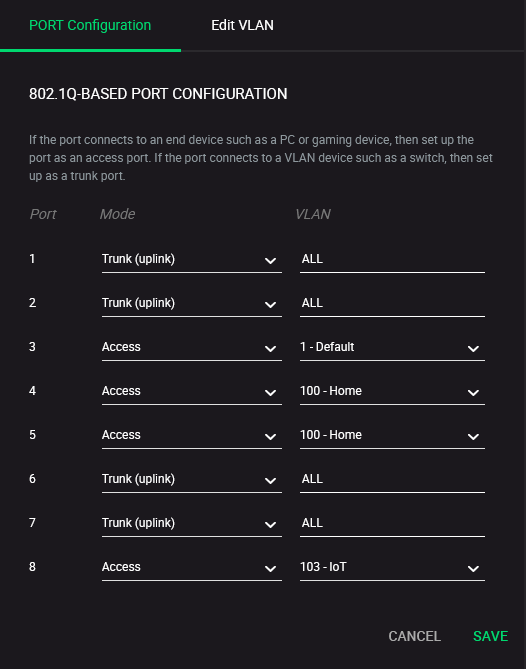

WAX630 AP is connected to pfSense using a managed switch.

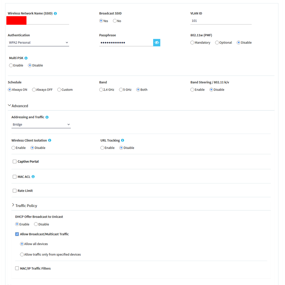

WAX630 AP broadcast 3 SSID on different VLAN.
EAX15v3 is connected to a single VLAN SSID.

    Currently there is a GS308EPP managed switch between the router and AP (forgot to mention in original post)
    This one is set to Basic 802.1Q VLAN with the following config, where router is connected to port 1, AP to port 7.

    Issue might have something to do with VLANs? As the AP broadcast an SSID per VLAN, i would suspect the WIFI client should not be VLAN aware?

      I am suspecting that the problem might be the DHCP broadcast to unicast setting in the AP, though I am not seeing exactly why.  I'd try disabling that setting next.
      That setting tells the AP to convert the DHCP broadcast response from the router to a layer-2 unicast response using the requester's MAC address.  In this particular situation, I am not sure whether the AP would use the extender's MAC address or the translated MAC address of the PC.
      1. If it is using the extender's MAC, then the extender would process the response itself and never send it on to the PC.
      2. If it is using the translated client address, then I am thinking the AP then might not know that it needs to send the response to the extender.
  • This is the AP SSID config
    Advanced rate selection set to standard
