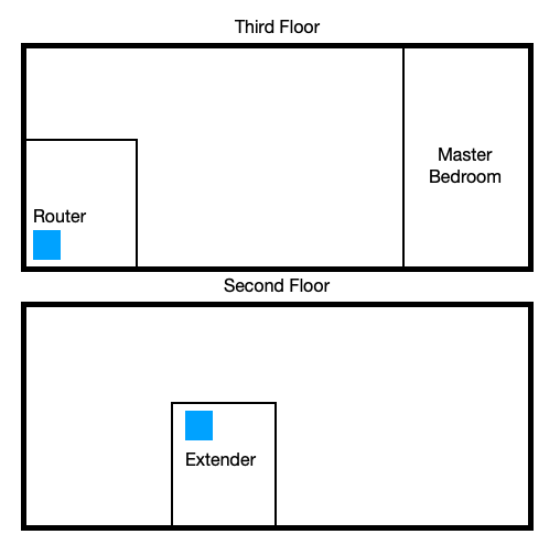

I just got the EAX80 extender for our three story home and it totally solved the issue with two dead spots at the front of the house opposite of the router but now I am getting worse wifi in the master bedroom and I don't know why.
Before the extender I would get 200-300 mbps download in the master bedroom that is on the same floor but opposite side of the house as the router. Now with the extender I get 50-100mbps and sometimes it's so bad I can't even use it. It seems like my phone is still trying to use the extender network even though I thought it would switch to the router once I was in the master bedroom? I see that some of my devices are on the router and some are using the extender based on location, but those devices don't move like me and my phone.
Is there some configuration I am missing? I have 2.4 and 5 set up and smart connect disabled. I tried enabling smart connect on the router but then everything blew up and the extender stopped working since the networks were now one. Is smart connect required for devices to do the handoff between locations?
