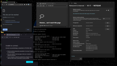

EAX80 Nighthawk AX8 Reset and Cannot Connect
I needed to reset my EAX80 Nighthawk AX8. I pressed the reset button for 7 seconds and after I let go, the router rebooted. By the fact that my SSIDs were no longer transmitting and a new SSID NETGEA...

I've tried that. I believe that I have seen both 230 and 250 as my default gateway. This morning, 250 is coming up. I also tried MyWIFiExt and same result.

I held the reset for 30 seconds. As soon as released, the router reboots. I tried Chrome, Edge, and Firefox. Interesting thing I noted this time is that the WiFi connection is not getting DHCP. You can see from IPConfig that the WiFi connection is using a private 169.254.125.80 IP.
