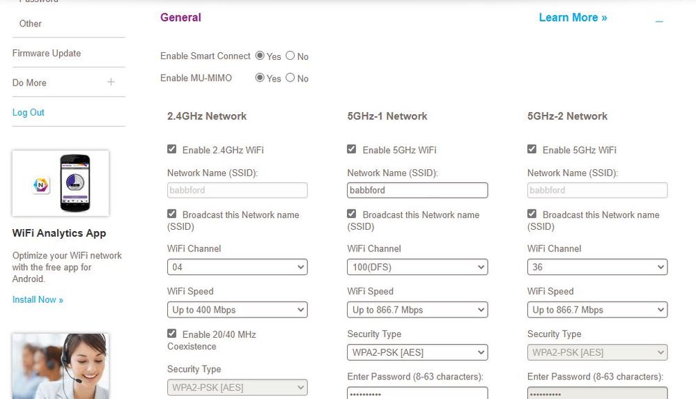

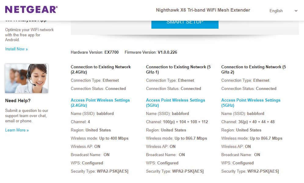

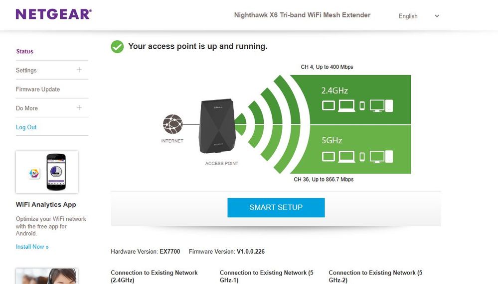

I've attached some pics of the settings which brings me to a gray area. I reset the unit while it was on by holding in the Reset button for around 8 seconds when I noticed the LEDs changing. It came back up with no settings saying it needs to be set up. Once I clicked on Access Point it filled in the rest with previous settings. Not sure what to make of that but it works left it.

Looks pretty solid and like its working. Hope it stays working.
The one thing you might look at changing is the one 5ghz channel is set on a dfs channel. If you have anything broadcasting on dfs channels in your area, it can cause it to drop for a period of time as it changes to a none dfs channel. You might just set it to one.
