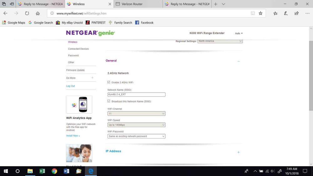

Hello. I have updated to the latest firmware version. Here is the genie screenbelow. Iam still having problems connecting to the network, even though getting three bars. Thank you for your response.
StephenB
Oct 01, 2018Guru - Experienced User
You are showing only the extender network. Can you also tell us about the extender->router link quality? Posting the same page as schumaku did would help (using the web browser to reach the extender web ui, not the app). Also, what color is the router link LED on the extender?

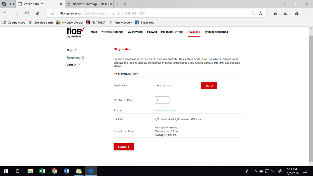

- KundtzOct 02, 2018Aspirant
In looking at the Verizon-supplied network access webpage, I am able to test the connectivity to the extender-see below picture. I think that this shows the speed results too.
The router link on the extender is green.
Problem is that NETFLIX streaming is stalling. Sometimes recovers, but often ends with message that the internet connectivty is lost, even though the ipad shows two or three bars.
Smaller video like youtube is no problem. However, I also run into the problem if trying to watch live TV on the Verizon FIOS mobile app.
