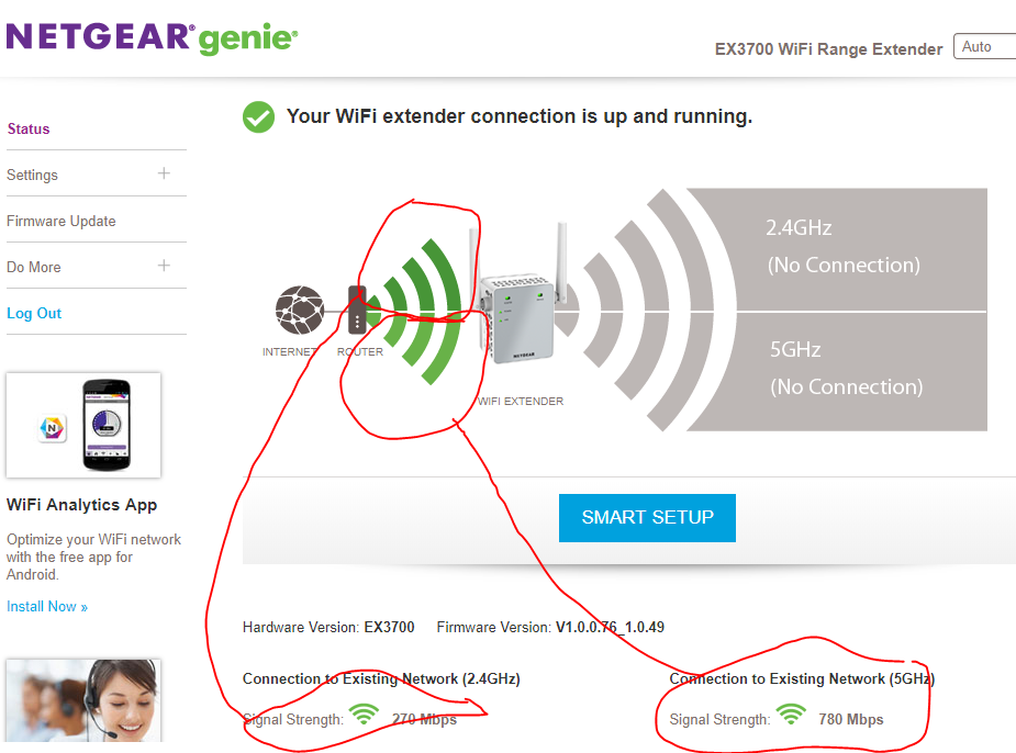

Ok, I could really use some help here. I am experiencing the same issues noted in this and multiple other threads.
- Good connection with my router, but any device that tries to connect to the extender does not have internet.
- All lights are green. Green light also when a device connects to the extender.
I've tried:
- Factory resets
- Powering on/off
- Changed channel on router
- Updated to latest firmware today
- Confirmed my router does see the extender
This is getting to be a bit of a joke. It is also d@#^ near impossible to get through to Netgear support, even after registering. (Get into a useless loop of non-info and references to ARLO)
