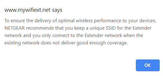

Can I use the same SSID as my main router? The option to use the same SSID is not available in this firmware as I guess the mesh network functionality only came out in 1.0.1.78.
What's the impact of using the same SSID?
Edit - guess that attached answers my question.
