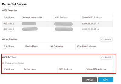

Also, when I log in to the extender and look at my connected devices, even though my phone tells me I'm connected to the extender, I don't see any devices listed in the extender's connected devices list.
