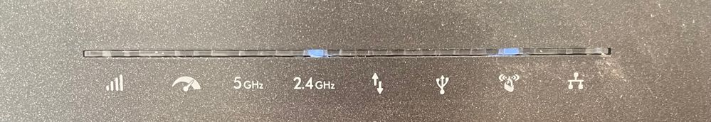

Hello I'm in relatively inexperienced when it comes to this realm. I have Xfinity 1.2Gbps download speed going to a CM2000 -> ethernet cord -> AC3200 R8000 -> X6S TriBand Extender EX8000. Up until yesterday it all worked fine. After restarting my internet after a huge download from a device connected wirelessly to my EX8000, it hasn't worked correctly. Currently, the router works fine, and the 5Ghz and 2.4Ghz wifi networks are on and working. However my EX8000 is not working correctly. The "Link Status LED" is off, the "Maximum throughput LED" is off, and the "5Ghz LED" is off. The only LEDs that are on are the "2.4Ghz" and "WPS LED." They're both solid white. I have a device connected with a CAT6 ethernet to the EX8000 that is not getting any internet. I tried resetting the modem, router, and extender all multiple times. I also reconnected the EX8000 to the R8000 using the WPS buttons method but that did not help either. Any help is appreciated I don't know what to do.

I tried to follow that but when I connect to network "NETGEAR_EXT" and then try to load "mywifiext" it just says I'm not connected to the internet.
