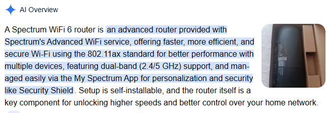

OK tried to login to my Router from ip address no luck, Spectrum WIFI 6 router talked to Spectrum internet provider, the told me "Our spectrum wifi router do not offer customers the option to log into the router." looking on my laptop , shows network but not attached devices, So is there anything to do with this problem? I've been trying for days, thanks

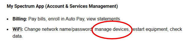

It appears that Spectrum WiFi routers are managed using a smartphone app called My Spectrum

Managing devices appears to be one of the features of the My Spectrum app:
A WiFi extender, such as the EAX12 may not have information about devices that are connected to the primary WiFi router.
