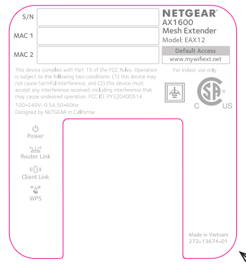

I believe the MAC address of the EAX12 should appear on the label on the back:
- TdraymAspirant
I went to spectrum, my account, my equipment found devices on network, it showed me 6 or 8 units but the most recent was a 7 or 8 digit thing so no way to tell if even related to mesh extender nothing matched numbers could be one of 2 tablets on network, Is there any 3rd party apps that could show what is all on this network, never knew it was going to be such a hassle, thanks for your time I just keep trying to an answer somewhere, worst case I just do factory reset, but I can't yet need wifi outside for genatorer app to be set up this week, hope it works with extender all lights all steady green, sign in to network with network name and network password which I know is working , thanks all
