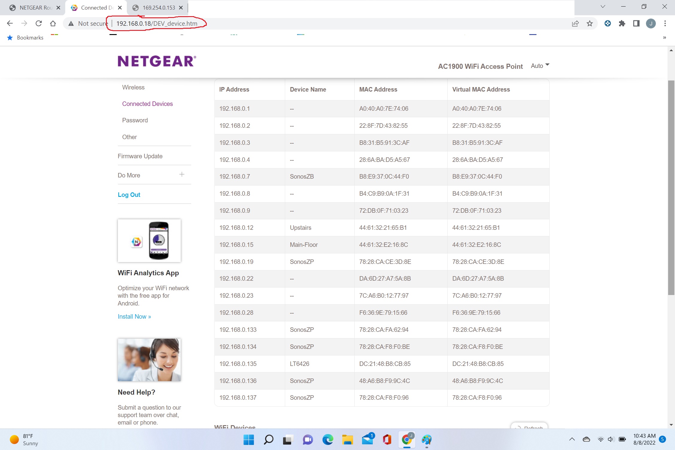

I have attached a pic of my router setup.  Since there is 1 attachment allowed per post I will add 2 more of my attached devices as shown on the router and then attached devices of the garage extender (set up as access point)

      Garage Extender attached devices.

        it could be the router lost its config  because the extender isn't the only one outside of the 0.1-0.100 range.
        Is there a reason you set a more narrow range?
        It could be the storm corrupted something (not the first time I've seen that).
        Or it could be the generator was a non-sine wave device and caused issues.
        You might try factory resetting the router and re-doing its setup in case something was corrupt.
