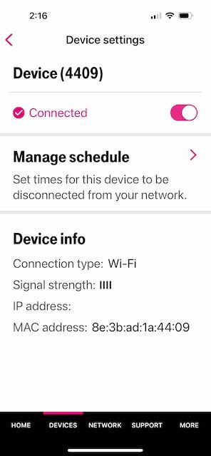

      You would think that is so, but here is what I see when I track the EX2700 down via MAC address: no IP. If I switch to the WiFi network on the EX2700 and then check the details on my Macbook Pro, it has the same IP address as my Mac.

        You might have to contact tmobile about it. If the range extenders working, the router is giving it an address. If its not displaying it, that'd be on the tmobile device.
