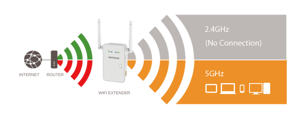

When I say the signal is red, this is what I am referring to. On the setup page, not the extender itself.
