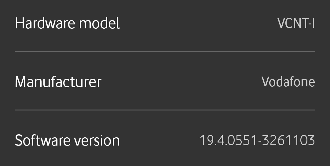

I don't know the exact specs of my router, but I have included a screenshot of the information that comes up through its management app. Any help would be appreciated!

- plemansGuru - Experienced User
did you try changing what channel the router is broadcasting on? 2.4ghz is more sensitive to interference
Also, did you setup the extender using WPS setup or using the installation assistant?
