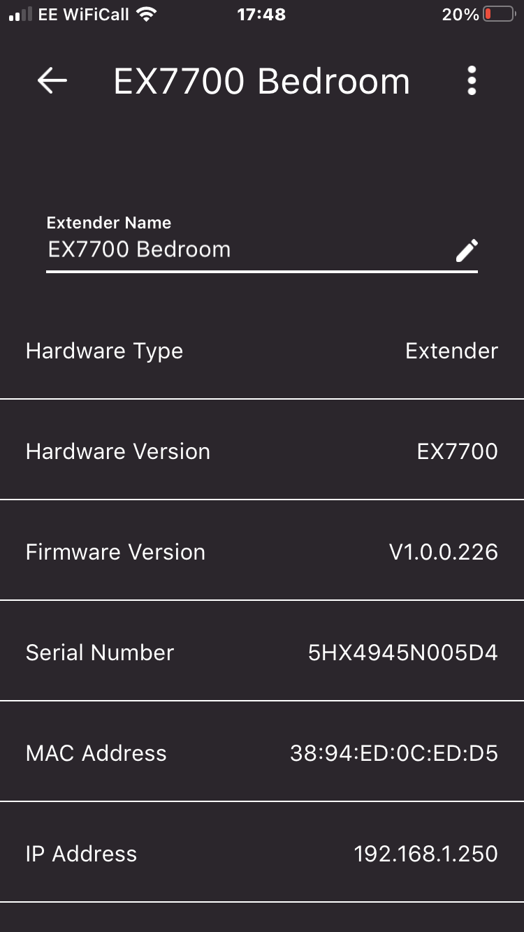

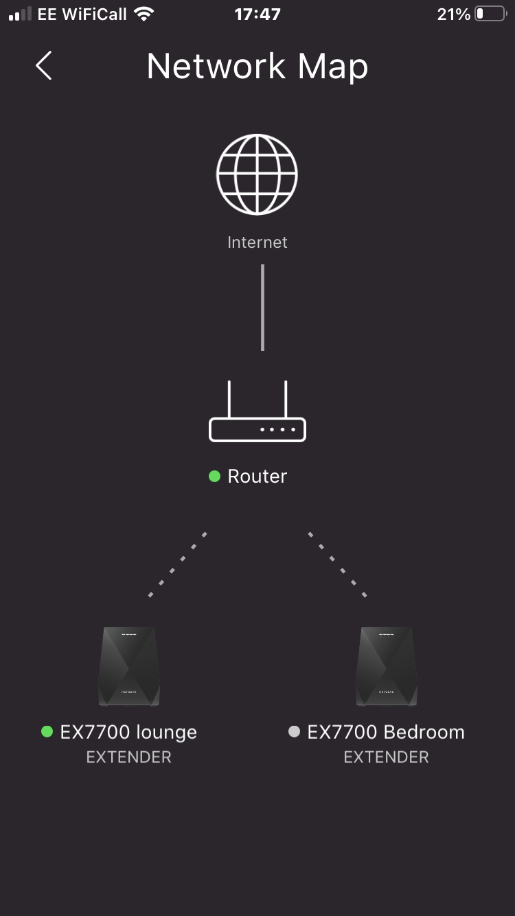

Thank you for reaching out to me. The firmware is 226 which is exactly the same as my other unit which is the same model that I use in another part of the house so it can’t be software ! You say try a different version but this is not something I can do from the app. That just updates to latest version. If I reboot with either the app, or power button the unit comes back on eventually with no lights on and does not show on the app. This is definitely a hardware issue but I know you are the expert. I appreciate your help and advice. Regards. Colin.- calia1120Jan 28, 2023InitiateIt's a known issue with earlier hardware - ran into it myself. Firmware rollback solved the problem for me, make sure to avoid the .210 as well because it has the same problem - https://community.netgear.com/t5/WiFi-Range-Extenders-Nighthawk/EX7700-keeps-factory-resetting-every-few-weeks-Loses-all/m-p/2213644
