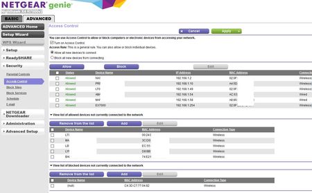

Hi Everyone,
I hope somebody has a suggestion for my Access Control issue with my Nighthawk X4 R7500v2 with Extender EX7000:
The extender shows up in Access Control just fine. All works until...

The extender is mapping the mac addresses of it's attached devices to "virtual" mac addresses.
You can try connecting your devices with the ACL turned off, and note the new mac addresses you'll see in the router. Then you'll need to add those new addresses to the ACL list. You can also see this mapping in the extender's device list ( https://kb.netgear.com/26262/How-to-setup-devices-on-EX7000-when-MAC-address-filter-is-enabled-on-the-router ).
Note this will also interfere with any address reservation you are doing for the client devices - the Nighthawk won't let you reserve the same IP address for two different mac addresses.

- mpl2910Dec 22, 2018Aspirant
Hi Stephen,
Thank you for your input. As you might be able to see from my second picture, the MAC address that was in the routers ACL was the virtual MAC of my EX7000. All virtual addresses on my extender start with 02:0F:B5.
I entered the virtual address and the physical address into the ACL list and enabled Access Control/Blocking new devices. Yes, no more "Blocked" for my EX7000.
My extender shows successful device to extender connection and all looks good. However, I cannot reach the Internet with the devices that are connected to the LAN port on the EX7000. My router does not show anything blocked. My test laptop has "Allowed" next to it in the ACL list and shows the virtual MAC. I cannot reach the Internet while Access Control/Blocking new devices is enabled. Disabling the option allows my laptop to reach the Internet.
I rebooted all three devices without success. I added the physical MAC address to the ACL but that did not help either.
Any ideas?
Thank you so much for directing me in those dark days ;-)
- StephenBDec 23, 2018Guru - Experienced User
I did see the two virtual macs (for the EX7000 and the NAS), but they were set to blocked in your screen shot.
Of course it should be working with the mac addresses set to allowed in the ACL. Perhaps DexterJB or Christian_R will have a suggestion.

- mpl2910Mar 07, 2019Aspirant
Hi Christian,
Sorry for the long delay.
The ACL/Internet problem is solved after factory resetting the router and the extender and reconfiguring both.
However, the Extender does only connect to the router if I enable broadcasting the SSID's on the router. Entering the SSID and password in manually will not connect the Extender to the router. Changing the broadcast option on the Extender does not effect the connection to the router. Even once connected successfully, I cannot switch the router to stop broadcasting without loosing the connection to the Extender.
Long story short, this is not an option I like and the hole process has reduced my trust in the products. I will pull a Ethernet cable and stop using the extender.
