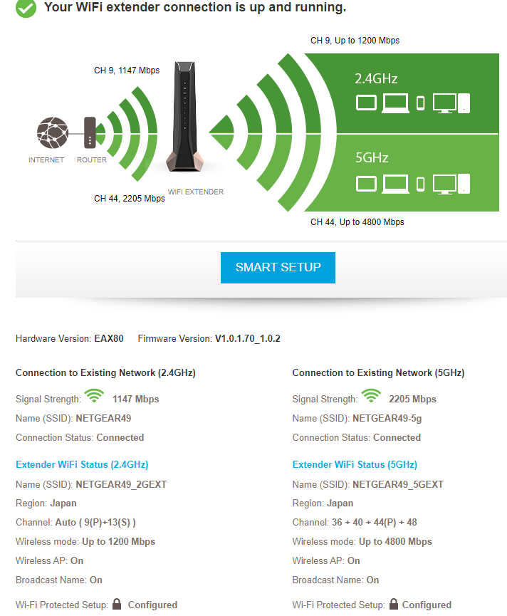

    got a copy of the status page?

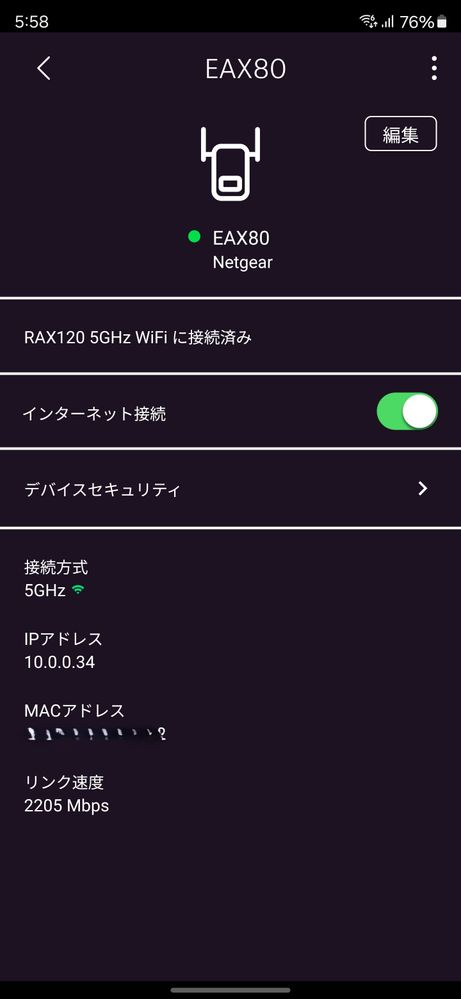

      I attached my WiFi extender screenshot.

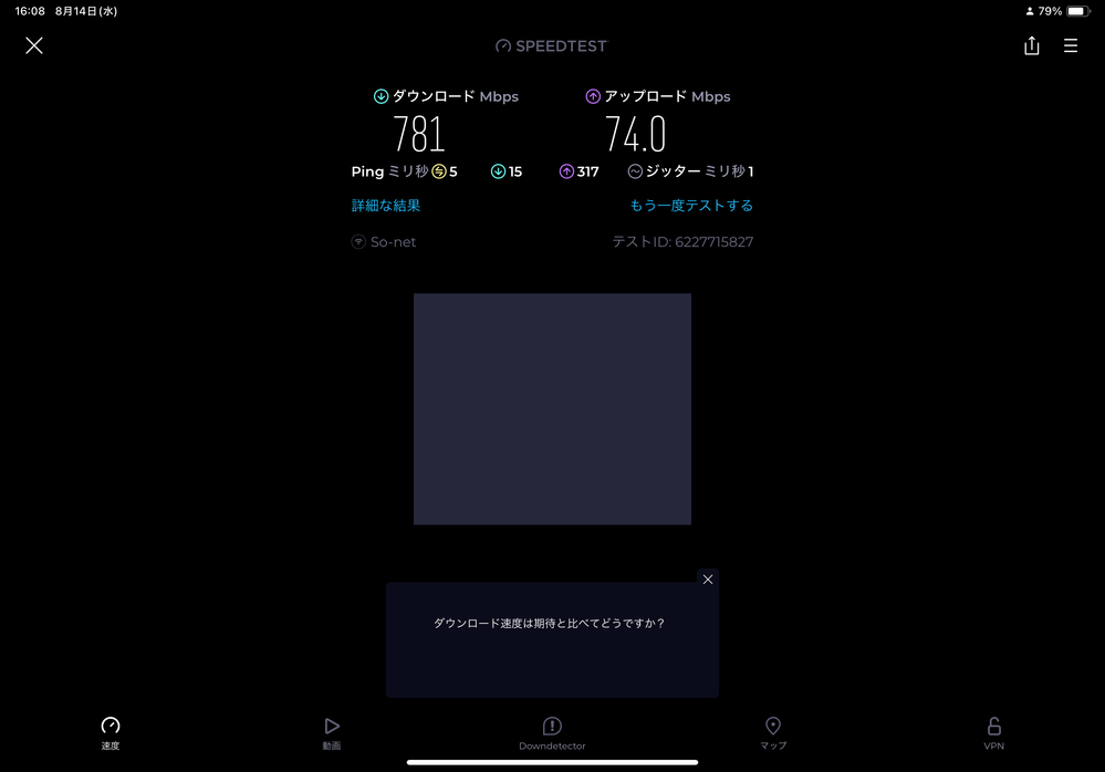

      My WiFi extender hardwired speed is
      Download is 781 mbps
      Upload is 74.0 mbps

        Is that a hardwired connection?
        What device are you testing on?
        Have you tried a different device?
        Or tried a different speedtest site?
