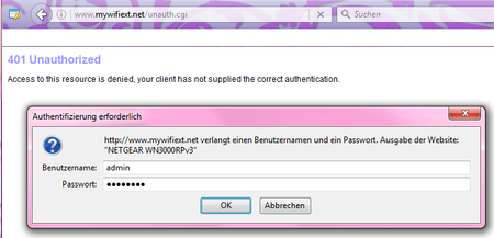

Hallo zusammen und Guten Tag:smileyhappy: (Bitte entschuldigt die Übersetzungsfehler in die Englische Sprache.) Am 2. Mai 2016 haben wir den Netgear WLAN-Repeater (Verstärker) N300 Modell WN3000...

doraemon
May 06, 2016Prodigy
You may have changed the password to something else.
Try other password that you might have used.
Still unable to access? Reset the extender and start all over again.

doraemon wrote:You may have changed the password to something else.
We have never entered a new password.
As I said / written in post 1: "(...)according to the installation guide 'wireless repeater N300 model WN3000RPv3' we have installed the wireless repeater (...)" and as described on page 18 we proceeded.

Here I would like to write how the support -amongst other- has helped me: (Logged in account - Support with case number)Translated with google translater:
"Dear Mrs. __,
Thanks for the feedback and the notified information.
Once you are connected to the address _EXT and got an Internet connection, try accessing http://www.mywifiext.net. or http://www.mywifiext.net/start.htm with at least one other browser. If you have tried so far with Safari, test it on both the iPhone and on the desktop with Firefox if possible, and then enter the username: admin and password: a password.
If still not working, access, then the extender have to be set back to the factory settings.
Place the Extender to factory settings: [The Extender is powered on and on] Take a paper clip and stand for 30 seconds into the reset hole - not shorter; then take the Extender for 10 seconds from the power and make the power supply recovers.
Follow the instructions under http://www.downloads.netgear.com/files/GDC/WN3000RPV3/WN3000RPv3_QSG_GR_18Aug2015.pdf on page 8 of the Installation Guide -. Connecting through installation of the Web browser and run as the reinstallation
