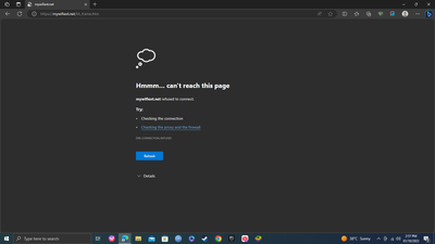

I have been using a Wifi Range Extender WN3000RP, It was working fine until suddenly it stopped working. So I reset the device using the factory reset button. After that whenever i try to connect to mywifiext .net page it gives me refused to connect error, I also tried using IP address to get to the main login page even then it refused to connect. So far I've tried factory reset multiple times and tried to get into settings using WiFi and Ethernet but still no luck. Mywifiext webpage works when i'm connected to the internet but not when i connect the device's wifi to set it up basically. What can i do?

    While connected to the NETGEAR_EXT - your PC will get a LAN IP from the 192.168.1.x/24 assigned - have tried http://192.168.1.250/  already? Everything under the assumption this is the only Netgear extender in range of course.
    Alternate, you can try to assign a static IP like 192.168.1.123/24 (255.255.255.0) to your PC LAN adapter, and connect the WN3000RP to the PC Ethernet. Here again, try the ubiquitous http://192.168.1.250/ again.
